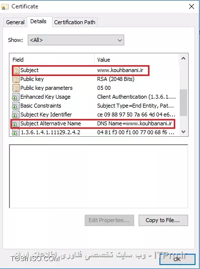

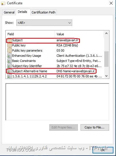

تنها تفاوتی که من تو این دوتا دیدم یکی issued to :
domain.ir بود دیگری www.domain.ir
در بخش subject و alternate subject name هم همینطور بودند
نمیدونم شاید مشکل از اینه که www داره اولش!
چون اونی که www نداره درست کار می کنه

تو نصب Certificate نوشته بود:
This SSL certificate was already installed.
The SSL website is now active and accessible via HTTPS on these domains:
The SSL website is also accessible via this domain, but the certificate does not support it. Web browsers will show a warning when accessing this domain via HTTPS:
kouhbanani.ir
The SSL certificate also supports this domain, but this domain does not refer to the SSL website mentioned above:
www.kouhbanani.ir
