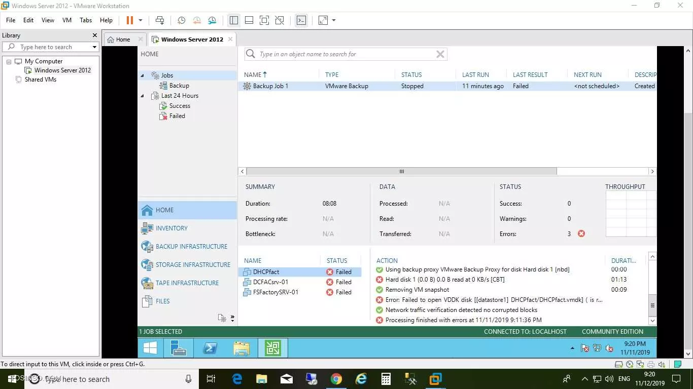

بنده میخام با    VEEAM 9.5از   VSPHERE5.1 بکاپ بگیرم با پیغام خطایی که
تصویرش را براتون ارسال کردم مواجه می شم
آیا  VEEAM9.5  با    VSPHERE5.1 سازگار هست ؟
لازم به توضیح هست که تا بحال هیچ بکاپی از  VSPHERE5.1 گرفته نشده و خیلی  مهمتصویر ارسالیه که این کار انجام بشه
لطفا راهنمایی کنید.

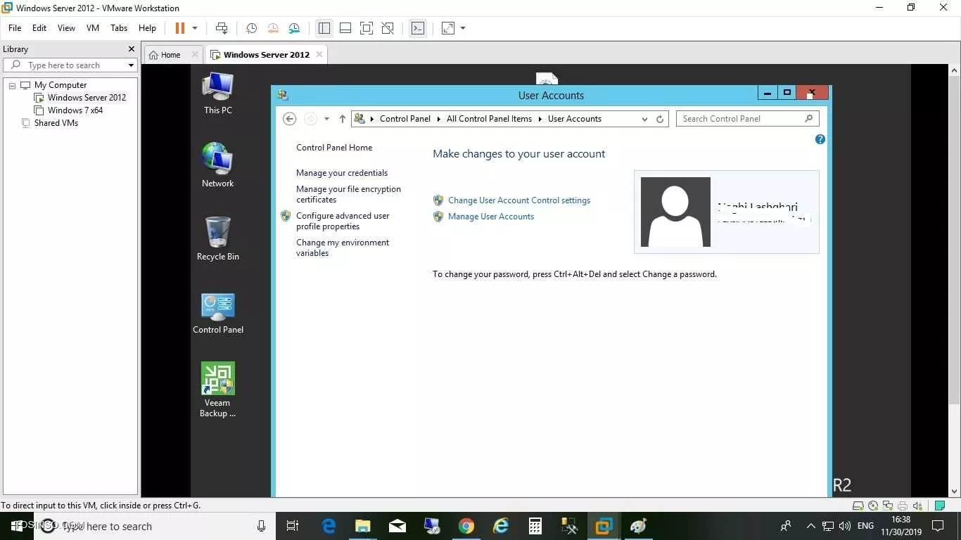

در کنترل پنل غیر  فعال کنید

اینم کپی پیغام
11/29/2019 9:05:27 PM :: Job started at 11/29/2019 9:05:23 PM
11/29/2019 9:05:29 PM :: Building list of machines to process
11/29/2019 9:05:34 PM :: VM size: 280.0 GB
11/29/2019 9:05:34 PM :: Changed block tracking is enabled
11/29/2019 9:05:45 PM :: Processing DHCPfact**  Error: Failed to open VDDK disk [[datastore1] DHCPfact**/DHCPfact.vmdk] ( is read-only mode - [true] )
Logon attempt with parameters [VC/ESX: [****];Port: ***;Login: [root];VMX Spec: [moref=6];Snapshot mor: [6-snapshot-7];Transports: [nbd];Read Only: [true]] failed because of the following errors:
Failed to open disk for read.
Failed to upload disk.
Agent failed to process method {DataTransfer.SyncDisk}.
11/29/2019 9:05:50 PM :: Processing DCFACs***-011
11/29/2019 9:05:50 PM :: Processing FSFactory**-011 Error: Failed to open VDDK disk [[datastore1] FSFactory****-011 /FSFactory***-011.vmdk] ( is read-only mode - [true] )
Logon attempt with parameters [VC/ESX: [*****];Port: ***;Login: [root];VMX Spec: [moref=7];Snapshot mor: [7-snapshot-7];Transports: [nbd];Read Only: [true]] failed because of the following errors:
 11/29/2019 9:07:25 PM :: All VMs have been queued for processin 11/29/2019 9:15:57 PM :
: Job finished with error at 11/29/2019 9:15:57 PM

من این مشکل رئ دارم ممنون میشم راهنمایی کنید
4/12/2022 12:58:29 PM :: Processing * Error: Failed to open VDDK disk [[*] */*.vmdk] ( is read-only mode - [true] )
Logon attempt with parameters [VC/ESX: [*];Port: 443;Login: [*];VMX Spec: [moref=vm-57];Snapshot mor: [snapshot-10354];Transports: [nbd];Read Only: [true]] failed because of the following errors:
Failed to upload disk. Skipped arguments: [vddkConnSpec>];

1- منظورتان User Account Contro هستیا چیز دیگه؟ از کدام قسمت چک کنم ؟
2-نسخه ویندوز 2012R2هست
پاسخ در 1398/09/09 توسط
UAC فعال هستش؟ اگر بله غیر فعالش کنید نسخه ویندوزتون چیه؟؟
غیره فعال نداره این
غیره فعال نداره این
