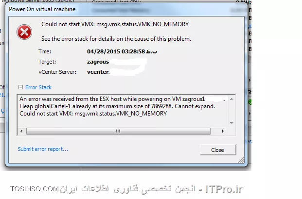

با سلام ، من یه سرورHP DL380 G8دارم که روشESXI 5.5نصب کردم.تقریبا از 50درصد منابع سخت افزاری رم و سی پی یو استفاده کردم ولی الان که میخوام ماشین مجازی جدید روشن بکنم ارور میده
Heap globalCartel-1 already at its maximum size of 7869288.
 Cannot expand. Could not start VMX: msg.vmk.status.VMK_NO_MEMORY.

با سلام طبق سایت VMware این مشکل مربوط به hp-AMS(Agentless Management Service) میباشد که در ورژن جدید یعنی 10.0.1 حل شده.شما یا باید اونو آپدیت کنید یا اینکه اگه ازش برای مانیتورینگ سرورتون استفاده نمیکنید اونو حذف کنید
This issue occurs with ESXi hosts running on HP hardware with these versions of AMS:
hp-ams 500.9.6.0-12.434156
hp-ams-550.9.6.0-12.1198610
hp-ams 500.10.0.0-18.434156
hp-ams-550.10.0.0-18.1198610
Resolution
This is a known issue affecting ESXi 5.x.
To resolve this issue, upgrade to AMS version 10.0.1.
For ESXi 5.0 and 5.1, see HP Agentless Management Service
 Offline Bundle for VMware ESXi 5.0 and vSphere 5.1.
For ESXi 5.5, see:
HP Agentless Management Service Offline Bundle for VMware vSphere 5.5
HP ESXi Offline Bundle for VMware vSphere 5.5
Note: The preceding links were correct as of April 16, 2015.
 If you find a link is broken, provide a feedback and a VMware employee will update the link.
If upgrade is not an option, work around this issue.
To work around this issue, remove the package on all
 hosts running on one of the preceding AMS versions.
Note: In some cases, commands running on the ESXi host fails with cant't fork.
 In this case, the virtual machines running on the ESXi host needs
 to be powered off and the ESXi host rebooted.
Run this command to verify the installed versions of AMS:
esxcli software vib list | grep ams
To remove the package on all hosts running on these AMS versions:
Log in to the host using SSH. For more information,
 see Using ESXi Shell in ESXi 5.x and 6.0 (2004746).
Run this command to stop the HP service (does not persist on reboot):
/etc/init.d/hp-ams.sh stop
Run this command to remove the VIB:
esxcli software vib remove -n hp-ams
Reboot the host.
