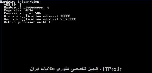

سلام به شما دوست عزیز،فکر نمی کنم به غیر از API های ویندوز راه دیگه ای وجود داشته باشه:
#include <windows.h>
#include <stdio.h>
#pragma comment(lib, "user32.lib")
void main()
   SYSTEM_INFO siSysInfo;
   // Copy the hardware information to the SYSTEM_INFO structure.
   GetSystemInfo(&siSysInfo);
   // Display the contents of the SYSTEM_INFO structure.
   printf("Hardware information: \n");
   printf("  OEM ID: %u\n", siSysInfo.dwOemId);
   printf("  Number of processors: %u\n",
      siSysInfo.dwNumberOfProcessors);
   printf("  Page size: %u\n", siSysInfo.dwPageSize);
   printf("  Processor type: %u\n", siSysInfo.dwProcessorType);
   printf("  Minimum application address: %lx\n",
      siSysInfo.lpMinimumApplicationAddress);
   printf("  Maximum application address: %lx\n",
      siSysInfo.lpMaximumApplicationAddress);
   printf("  Active processor mask: %u\n",
      siSysInfo.dwActiveProcessorMask);

||http://programming.tosinso.com/files/get/04eaa918-4d2d-4fcb-8df6-34cfda9c9bd0||
