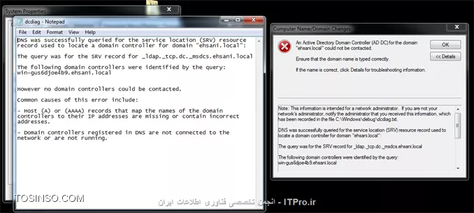

کاملا صحیح DNS و Gateway ها رو تنظیم کردم و پورت ها را در TMG باز کردم
اما زمانی client رو میخوام join به دامین کنم به ارور زیر مواجه میشوم
||http://network.tosinso.com/files/get/855c5d0c-1b91-4889-880c-30bedfe3bbcb||
<ltr>
Note: This information is intended for a network administrator.  If you are not your network's administrator, notify the administrator that you received this information, which has been recorded in the file C:\Windows\debug\dcdiag.txt.
DNS was successfully queried for the service location (SRV) resource record used to locate a domain controller for domain ehsani.local:
The query was for the SRV record for __ldap.__tcp.dc._msdcs.ehsani.local
The following domain controllers were identified by the query:
win-gus6djoe4b9.ehsani.local
<ltr>
DNS was successfully queried for the service location (SRV) resource record used to locate a domain controller for domain "ehsani.local":

مشکل مربوط به نام Domain شماست
سیستم رو که می خوای Join کنی به جای اینکه ادرس EHSANI.LOCAL از dns پرسیده بشه با پروتکل (NBNS(netbios توی اون رنج شبکه broadcast میشه برای همین نمی تونی اونو join کنی
