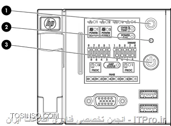

مدل سرور HP DL380G7 , و دارای 2 عدد ماژول پاور می باشد.

||http://network.tosinso.com/files/get/84bf2734-cd57-47dd-964d-4381ec0b70e2||
1 - UID LED and button
<left>
Blue = Activated
Flashing blue = System being remotely managed
Off = Deactivated
<left>
2 - System health LED
<left>
 Green = Normal
Amber = System degraded.
Red = System critical.
<left>
3 - Power On/Standby button and system power LED
<left>
Green = System On
Amber = System in standby, but power is still applied
Off = Power cord not attached or power supply failure
<left>
Blue = Activated
Off = Deactivated
Green = Normal
Green = System On
