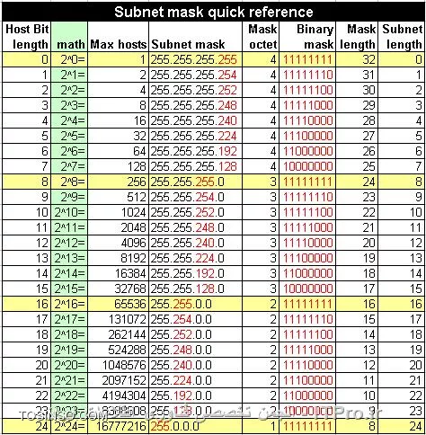

||http://network.tosinso.com/files/get/41856f7f-3bfd-414e-91bb-b5a894251fa4||
